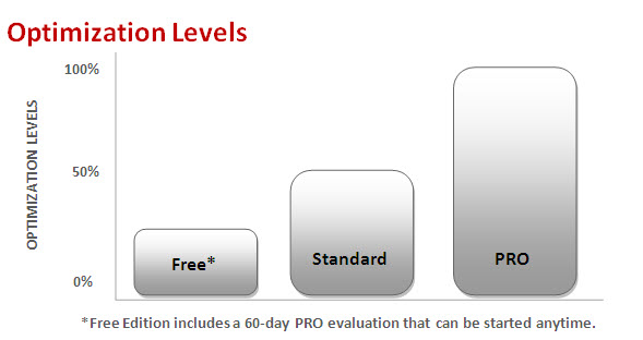

Hola!, según leí en un cursito de microchip que estoy haciendo, el XC8 gratis, te genera un programa que ocupa el doble de memoria de lo que ocupa en verdad.
Me parece que es eso, saludos!

Edition Types
MPLAB® XC Compiler PRO Edition:
    Provides powerful code optimization at better than 50% when compared to the free edition, giving the most efficient memory usage
    Available as single-user, node-locked licenses or floating network licenses
MPLAB® XC Compiler Standard Edition:
    Provides a lower cost compiler option with a 20-25% code optimization when compared to the free edition
MPLAB® XC Free Edition:
    Supports all the devices and commands of the Standard and PRO Editions
    No time or memory restrictions
    Limited code optimizations
    Unrestricted use—ideal for a low-cost academic or commercial solution
    Allows for all the code optimization and commands of the PRO Edition for 60 days – you decide when to turn it on.
        An option to activate the use of the PRO Edition features and optimizations is included. After 60 days, the compiler will revert back to the levels of the Free Edition
https://www.microchip.com/pagehandler/en_us/devtools/mplabxc/
