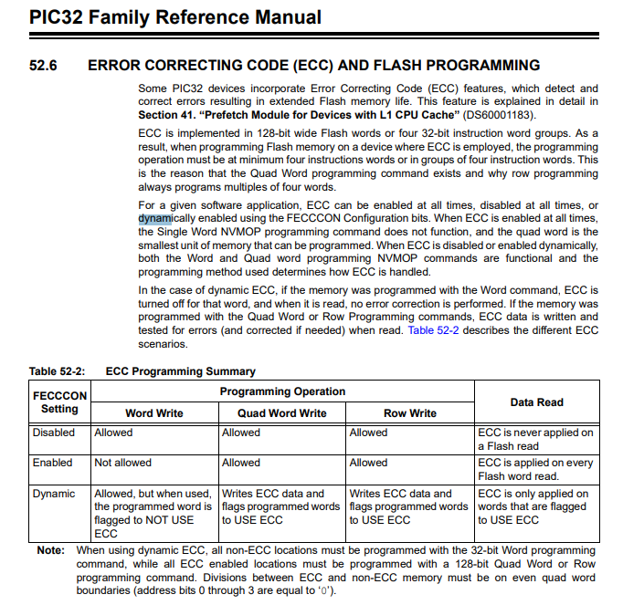

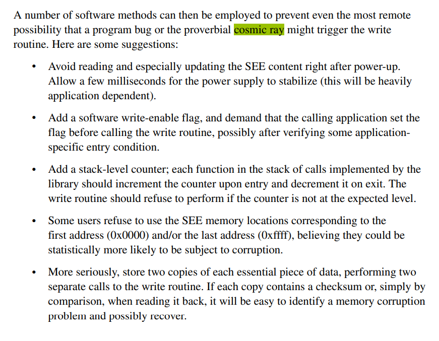

  Aprovecho que el iPhone reconoce el texto de las imágenes y permite seleccionarlo, copiar, pegar etc. Te lo dejo yo copiado y pegado en texto:
  A number of software methods can then be employed to prevent even the most remote
posibility that a program bug or the proverbial cosmic ray might trigger the write
routine. Here are some suggestions:
Avoid reading and especially updating the SE content right after power-up.
Allow a few milliseconds for the power supply to stabilize (this will be heavily
application dependent).
Add a software write-enable flag, and demand that the calling application set the
flag before calling the write routine, possibly after verifying some application-
specific entry condition.
Add a stack-level counter; each function in the stack of calls implemented by the
library should increment the counter upon entry and decrement it on exit. The
write routine should refuse to perform if the counter is not at the expected level.
Some users refuse to use the SEE memory locations corresponding to the
first address (Ox0000) and/or the last address (Oxffff), believing they could be
statistically more likely to be subject to corruption.
More seriously, store two copies of each essential piece of data, performing two
separate calls to the write routine. If each copy contains a checksum or, simply by
comparison, when reading it back, it will be easy to identify a memory corruption
problem and possibly recover.

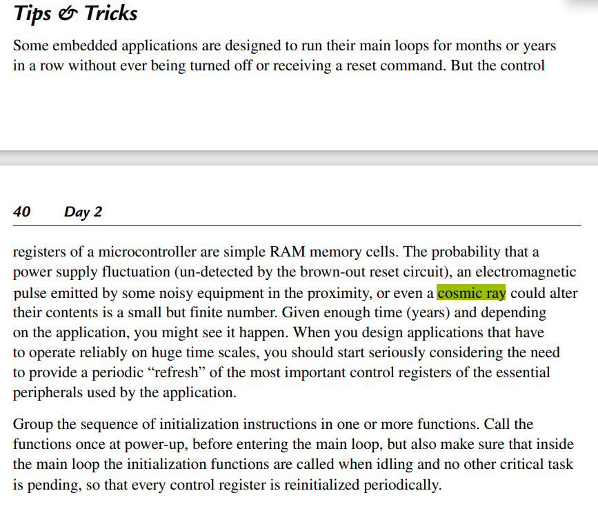

Texto de primera imagen.
Tips & Tricks
 Some embedded applications are designed to run their main loops for months or years
in a row without ever being turned off or receiving a reset command. But the control
registers of a microcontroller are simple RAM memory cells. The probability that a
power supply fluctuation (un-detected by the brown-out reset circuit), an electromagnetic
pulse emitted by some noisy equipment in the proximity, or even a cosmic ray could alter
their contents is a small but finite number. Given enough time (years) and depending
on the application, you might see it happen. When you design applications that have
to operate reliably on huge time scales, you should start seriously considering the need
to provide a periodic “ refresh ” of the most important control registers of the essential
peripherals used by the application.
 Group the sequence of initialization instructions in one or more functions. Call the
functions once at power-up, before entering the main loop, but also make sure that inside
the main loop the initialization functions are called when idling and no other critical task
is pending, so that every control register is reinitialized periodically.
Texto de segunda imagen:
Tips & Tricks
 If you store important data in an external nonvolatile memory (SEE), you might want
to put some additional safety measures in place (both hardware and software). From a
hardware perspective, make sure that:
● Adequate power supply decoupling (capacitor) is provided close to the device.
● A pull-up resistor (10 k Ohm) is provided on the Chip Select line, to avoid
floating during the microcontroller power-up and reset.
● An additional pull-down resistor (10 k Ohm) can be provided on the SCK clock
line to avoid clocking of the peripheral during power-up, when the PIC32 I/Os
might be floating (tri-state).
● Verify clean and fast power-up and down slopes are provided to the
microcontroller to guarantee reliable Power-On Reset (POR) operation.
If necessary, add an external voltage supervisor (see MCP809 devices for
example).
possibility that a program bug or the proverbial cosmic ray might trigger the write
● Avoid reading and especially updating the SEE content right after power-up.
● Add a software write-enable flag, and demand that the calling application set the
flag before calling the write routine, possibly after verifying some applicationspecific entry condition.
● Add a stack-level counter; each function in the stack of calls implemented by the
● Some users refuse to use the SEE memory locations corresponding to the
first address (0x0000) and/or the last address (0xffff), believing they could be
● More seriously, store two copies of each essential piece of data, performing two
